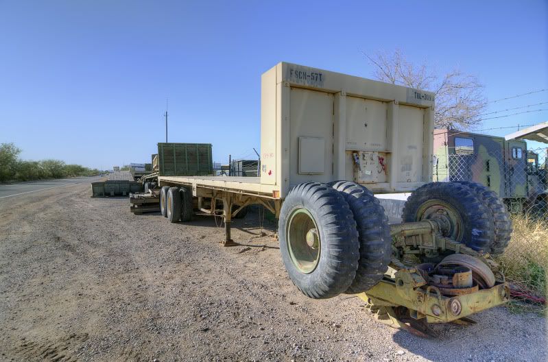

    Guys I wanted to take the time to post a methods of mine while processing HDR. I have been asked by many folks what my method is and I wanted to share with you all that are new to HDR.
    This is a tutorial for both very realistic and then a little more grunge/painterly and last using third party filters to make your image POP
    The first two are only Photomatix and Photoshop
    This will be a very long post sorry but hope you will find this informative. The image is not the best image but it should do.
    First grab your images and open with photmatix
    make sure you select 32bit box. You will use this for later
    Once you have gotten to the point where it shows you your first image click save and save it as original hdr
    Now select tone map and start using your sliders.
    here is mine for this image
    process the image and save as normal
    drag the orginal hdr onto photomatix icon
    now drag your saturation higher and white slider
    process and save as vivid
    drag the original hdr onto photomatix icon
    drag your saturation all the way down to the left and white and black sliders to the right
    process and save as shadow map.
    open all three in photoshop
    select all the shadow map image and copy and paste over your vivid.
    now change your opacity to about 30% deepening on what you want.
    select all on your normal image and cop and paste it over the vivid and shadow map.
    Now make it a vector mask in your layers window and use your paint bucket and paint it black
    Now use your paintbrush using white and paint areas that are to black and lost detail from your shadow map.
    Flatten image.
    duplicate image and select auto color. Change as you see fit.
    Now create a levels layer and adjust as you see fit for your image and flatten.
    done Final image
