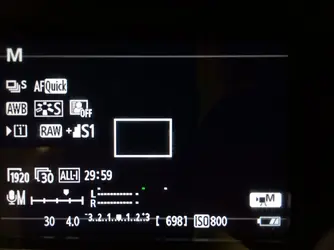

I shot this video yesterday and noticed that the exposure got darker as the video progressed. In the very beginning it was where I wanted it, but then got darker. When I turned off the record button the shutter speed was at 80 and I had set it at 60 in manual mode. Does the shutter speed change after setting it in manual mode while shooting video?

1/60 to 1/80 is a small shutter speed change - only 1/3 of a stop.
Starting at about 0:20 the already under exposed video starts getting bradually more under exposed out to about 0:26.
But no, in Manual mode the shutter speed should not change on it's own.

Thanks guys, Im still trying to figure this out. I don't see how after the shutter is set to accidentally change it by hitting something. I've been reading up on the 5D3 and have heard the camera is already under exposed so that might be part of the problem. Can such problems occur if the camera get hot? This was after about a half hour of shooting.
Did you have the auto lighting optimizer setting on? The little square with the guy and the lines. Turn that off.

Runnah, yes, I had that turned on! Do you think that was it? Perhaps I was hallucinating when I saw the shutter up at 80. Because I very mindfully put the camera in Manual mode and set the shutter speed at 60 to match the 30 allI frame rate...... I even had to go back in the quick menu to set it back down to 60 again afterwards, however, I did change the ISO after a shot or two and maybe it's possible I changed the shutter speed without knowing it.
