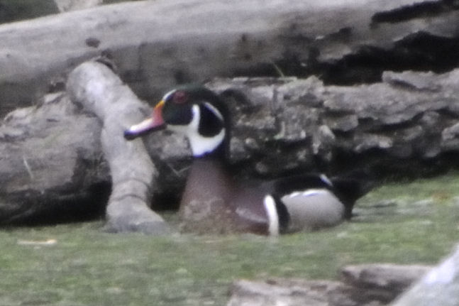

OK, here you go. Two photos of a Wood Duck on Radnor Lake taken a day apart. In the first one he is sitting on a limb of a sunken tree and on the second one he is floating in front of the tree so the range was virtually identical. Both are 100% crops of the NEF file. **BOTH ARE BAD** I already know that which is why they are in my "Junk Box" but they do serve a purpose here.
70-300mm @ 300mm hand-held
70-300mm @ 300 with Kenko 2x TC on a tripod
The second should have been sharper since I was shooting with a tripod. If anything it is LESS sharp than the hand-held shot from the day before.
