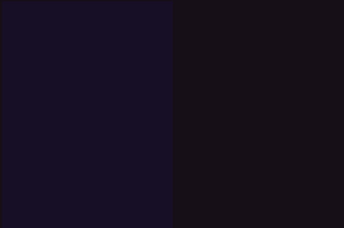

I would like to blend to similar tones so that instead of a hard line there is a blend or transition. Using the example image below, what I would like is to have a way merge the two so that it's a gradual transition...
All I'm seeing is a totally black image, that appears to be well blended as BLACK. LOL
Lol I see it now, I was on my phone earlier. I have an idea will post shortly
Simple Gaussian Blur applied to the center.
Like this????
