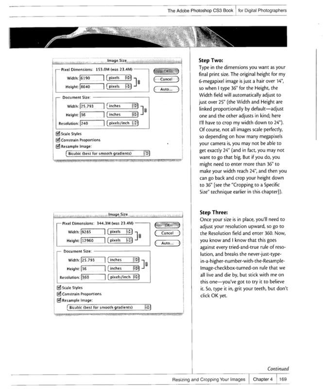

I also just read a good article where Scott Kelby uses bicubic sharper to make poster size prints form a 6meg file.
Maybe I'll scan it if I have time.
please do. even if i could make 8mb and 20mb files cleaner at poster size.

forgive the crappy scans.
