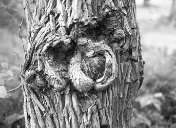

    Ultrafine002.jpg I've used a few r
    olls and found Ultrafine007.jpg it to be very sharp. Here are some examples:
    These were Ultrafine 400 in 120 shot with a Mamiya 645 pro tl. I have no experience with the 35m version but I wouldn't expect much difference.
