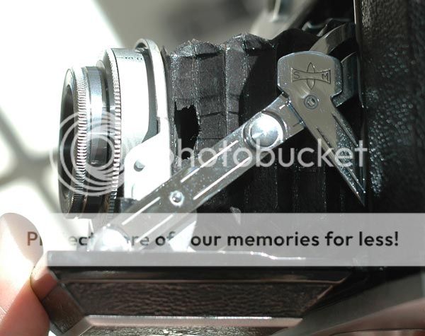

I use a product called Plasti-Dip. It is a thick liquid rubber that comes in different colors. I use black, of course, unless the bellows are a different color. If necessary I thin it with naphtha first. For large holes I first cover them with either black silk or thin gaffer tape and then brush on multiple coats of thinned Plasti-Dip. If you do it carefully the repair is almost invisible.
Here's Mamiya 6 folder I repaired using this method.
Before:
After:
