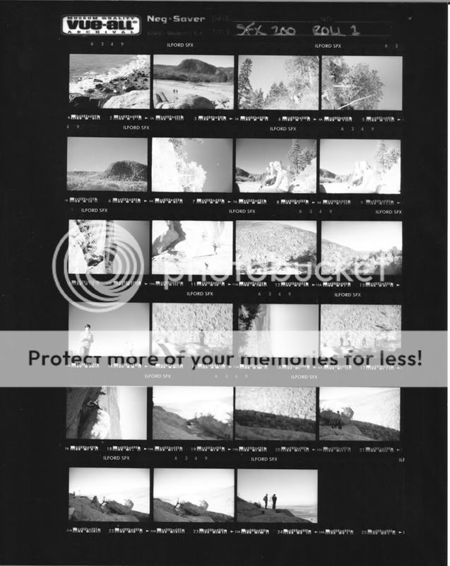

Here it is. Most of the images are overexposed (I meant to stop down a step, I did it backwards ;)), but hopefully you can get some idea.
EDIT: I have another half contact sheet somewhere from the same roll, which might have some more (properly exposed) photos on it. I'll see if I can track it down.
Wow, that stuff is really cool. I'm gonna order a bunch of it tonight. What kind of filter did you use, frXnz?
I used a B+W 090 red filter, which is like a #25 if I recall correctly. I kind of wish I'd gone a bit darker for the foliage stuff, but it works nice one stuff where I'm not looking for a real distinct infrared look.
