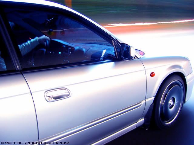

Here are two great examples of the look I am going for:

Those shots you have are only between 1/4 second and one second exposures. Xmetal and a few others have these set ups but I think they use bunjee cords to hold them down instead. Then again, I've not taken a shot like that but have strapped a video camera to a car hood with a tripod, bunjee cords and little pieces of pure rubber to prevent scratches and hold the tripod still. Still, those guys could tell you much more.

Tripod, Occy Straps, Duct Tape. - exposures start at 4secs and go from there. Buy 4 ND filters if you want to shoot during the day.
Thanks...Seeing your pictures...I am pretty confident in what you are saying. :thumbup:
As far as exposure, that just depends on what you want. It doesn't seem to me that you want the blur to be complete mush. Do several exposures ranging the exposure time. Depending on the effect, I would suggest shooting at dusk, angle the car to reflect the horizon line and glowing sky.

*cough*
I will admit for a first attempt it's an excellent picture. :)
My advice would be to shoot at night in a well lit environment (parking lot) where you can stretch the exposures as far as you want and not have to worry about changing light levels...though you'll need a good story if Security shows up.
