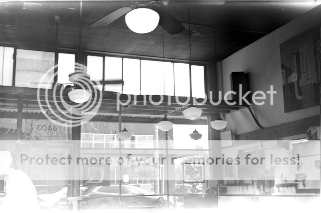

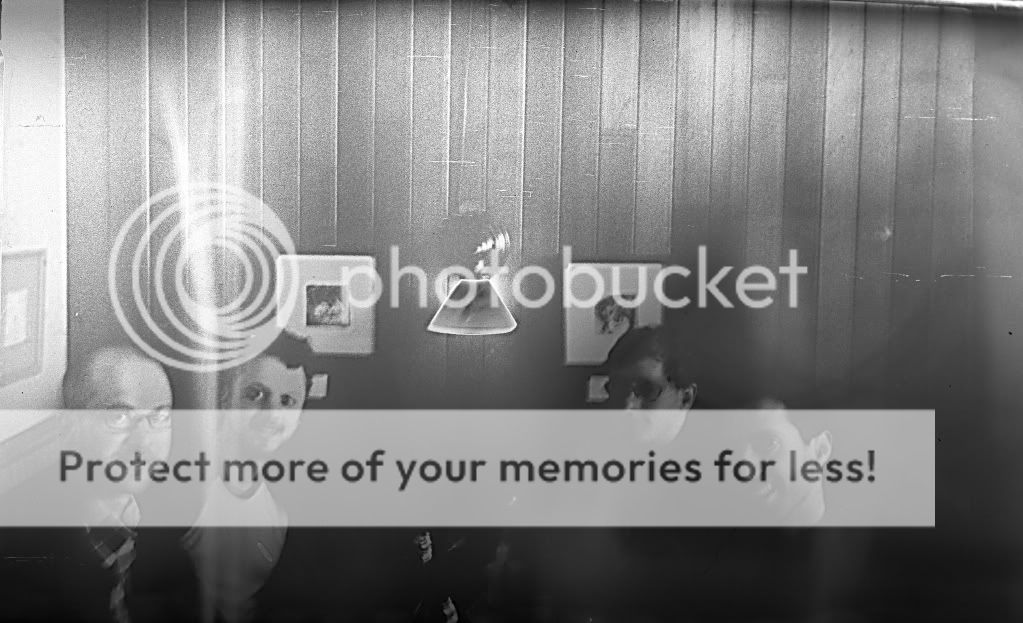

Anyway. Back in May I developed two rolls of black and white film. One was 35mm I wound onto a 120 spool and put in a Holga and the other was a medium format roll that my friend had taken (unsure of the camera). As I was developing it, and i'm not sure if this has anything to do with it, the canister fell over, top came off, and the top (35mm roll) came out and partially got exposed. Oh well, no biggie.
When the negatives came out some of the frames were developed as positives, right beside the actual negative images. On two of my friends 120 frames, almost the whole frame is a positive with just little pieces as negatives or half positive/half negative but very distinct lines of where it changes.
This is hard to explain in text so if anyone can help me post a picture (i read the sticky) that would be great.
Thanks Andy
This one is the negative inverted.
Same picture put the actual negative scanned.
This one is the negative directly out of the developing tank.
and it's inverted
The last one is exactly how it came from the scanned negative, not inverted
the funny thing is that only one or two frames on the 35mm and 120 film were like this. The rest of them developed normally as negatives.
You said that the film was only partially exposed to light when the tank fell over. That probably explains why there was only a partial effect.
Regards,
Helen
so it's just solarization? why such distinct lines? the rest of my 35mm roll, which is the top one that fell out and got kind of exposed, has the rest of the film with......uh big U shapes of light coming and exposing film on the side where the light would touch it. but not everything else.... i don't know. wierd.
