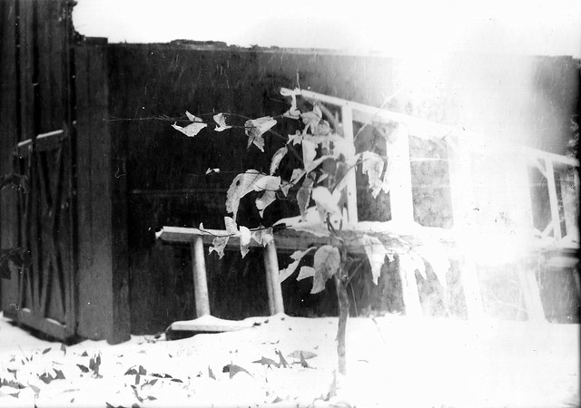

I loaded the OM2N with a roll of Ilford FP4+ and took some pictures during our "snow storm" last week. I overexposed @ 100 iso and pulled dev in d76 by 20%. Negatives looked pretty good so I pulled out an open box of Ilford glossy 5x7 and went to printing in Dektol. It wasn't long before I had a stack of photos that looked like this
83080012 by Nokinrocks, on Flickr
After changing chemicals, aligning enlarger, cleaning filters/lens, and so on, I finally realized the paper was bad. I did like the look in one photo (sorry about the frame but the white background needed some seperation)

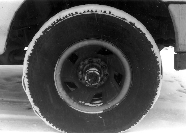

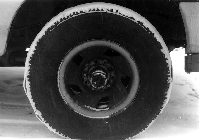

next two printed fine after opening new box of Ilford pearl. Both are split grade
F8 00 @ 5 sec / 5 @ 5 sec
83080009 by Nokinrocks, on Flickr
f8 00 @ 5 sec / 5 @ 7 sec

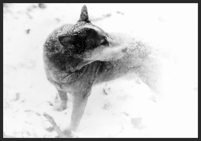

I like the car wheel photos, those turned out nice. I like the dog in the snow too, I'd just probably burn in that right side some (unless the negative is too thin or something) but in the snow that look seems to work.

Thanks.... Dog was a creative choice, actually have a good neg but the paper wasn't capturing shadow (right side). I went ahead and dodged it more. I am doing some test strips with Ilford 8x10 pearl I ordered from Ebay, seems to be turning a nice warmish yellow when drying. Any idea why? Old paper? I'm using stock Dektol around 68d.

On the other hand, did you make a good print of that dog and the first print you from the original post ? Honestly it looks to me like way overdeveloped negative. Old paper usually is producing a lot of fog reducing contrast and your prints are very contrasty.
Ebay deals, I know :banghead:... I just got a refund on paper that turned black soon as it hit the developer. The 5x7s above were multigrade iv rc deluxe glossy, the 8x10 is the same in pearl. I paid $15 plus $8 shipping for 35 8x10 sheets. The dog neg looked as good as the tire but they were printed on different paper. One side of that glossy was blown out, make another print and the other side was blown out (depending on the paper orientation). I jacked up the highlights pp in the dog pick but I'm sure it would print well on good paper. I prefer TMAX Dev and have a bottle but I am trying to use up a gallon of D76 that was already mixed. I just use a water 30 sec stop bath before fixing. Appreciate the tips.
