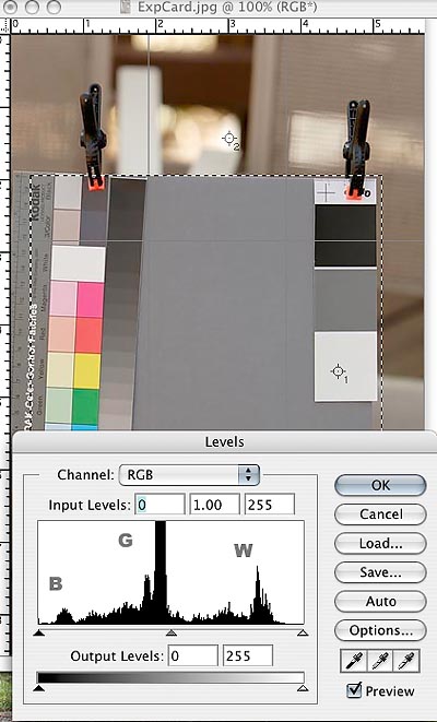

Something like this?
Thats the littel chap, although those setting look like they have come out of PS.
His are all out of the camera software, nothing happens in PS until I get the file!!!
