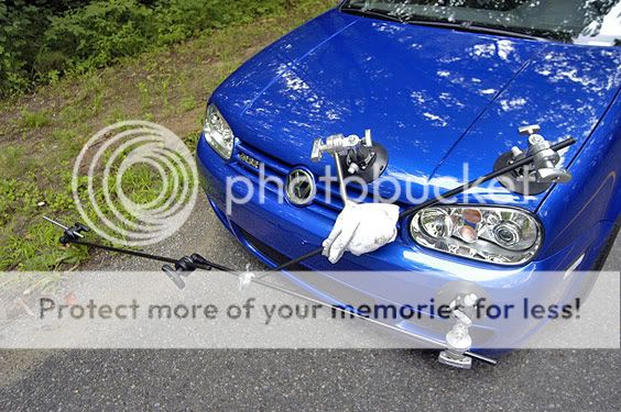

Now it's rather simple but still complex and time consuming to do, The time consuming part is planning and setting up the shot and the complex part is timing the shot perfectly and positioning the camera in the right position.
The 1st shot you saw was done using a tripod and shock-cord...
The Camera used was a Canon Powershot S45 and was set for a 5 second Exposure @ F8.0, No filters were used and it would've been taken around 7pm Daylight savings time.
Taking the shot is the other thing that would baffle any 'normal' person that just happens to be wandering past.
The Proceedure for taking a shot is (assuming you've already set up the rig to hold the camera in place):
1. set the shutter release timer for a 10-second delay
2. Start the car. (leave the drivers door open)
3. Release the shutter (starting 10 second delay till initial shutter release)
4. You now have 10 seconds to run back, jump in the car and drive around in a circle at about the speed of a brisk walk or even jogging pace.
5. Once the camera has taken the shot, brng the car to a steady halt.
6. Turn the car off for safety reasons (engine off, in gear/park, handbrake on)
7. go to 'preview' mode on the camera and examine your handywork!
There might be a few little fiddly bits i've left off here and there but with a bit of practice in the field and some common sense; it'll all work out.
