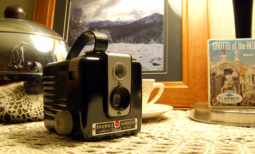

lathamemmons, if it looks anything like this, you might find this handy. :)
aside: What is it about those old manuals? They just wring my heart. :love:
yep terri thats the one

This is the camera that took all the photos:
