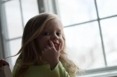

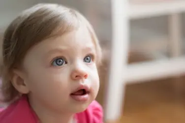

Here are pics. Unedited. The top two are at my home and the bottom two are at my kid's class. Would love any feedback.

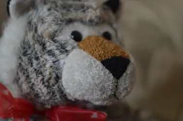

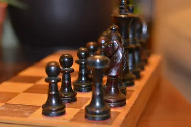

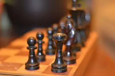

Here's my D3200 50mm set at f/1.8, the first shot is about 1.5ft away and you can see that the nose is the only thing in focus. The second one I was about 4 feet away and you can see that the stuffed animal is more in focus with the settings the same. For better focus close up you would want to increase the aperature.
I took these to demonstrate the DOF. I didn't shoot for exposure.

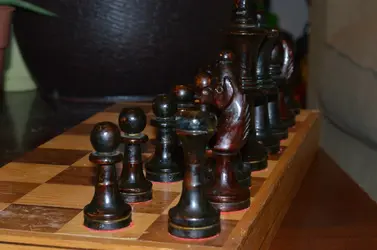

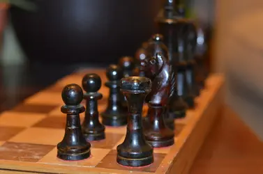

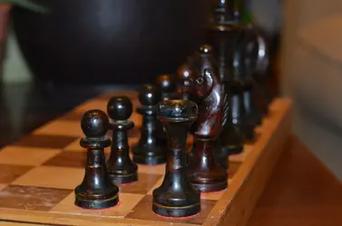

Here is another experiment I did showing how depth of field changes as the aperature is closed along with the amount of light captured as it closes.
I shot this on a tripod about 2ft away bumped up the aperature 3 f stops higher with each exposure starting with f/1.8. You can see how as the aperature closes, more of the pieces come into focus but less light is captured. I did 2 sets, one without the flash and the other with. I am showing the set with the flash. You can still see how the light is effected and the DOF. The set without the flash eventually became so dark with the same settings that you couldnt see it.
Notice how #1 looks much better than 2-3-4? (besides the focusing issue)
You have the subject being lit by the window. Large windows make GREAT light sources. If it wasn't for the distracting chair, too narrow DOF, and missed focus, this could have been a great shot.
As for the rest, notice how the light source is behind the subject? Your camera is doing the best it can given the scenario you are giving it.
For one, I'm assuming you're using matrix metering mode. This means the camera is looking at the entire scene and trying to expose it so the entire image looks 18% gray. Since there's huge bright light sources behind the subject, it's bascially taking that into account, averaging out the dark subject in the way of the light, and giving you that result.
The only way these would have resulted better for you is if you were using spot/center weighted metering and you exposed for the face. This means the background would have been completely blown out white as the camera would have tried to keep the shutter speed open longer or increase the ISO significantly so that only the area you were metering was 18% gray.
Otherwise, shots 2-3-4 really needed a fill flash.
Also, just because you have have an f/1.8 lens, doesn't mean you should always shoot in it. The DOF is extremely limited the closer you get to subject and you really want to get at least both eyes in focus--unless you're purposely using DOF to only draw focus to the point in focus.

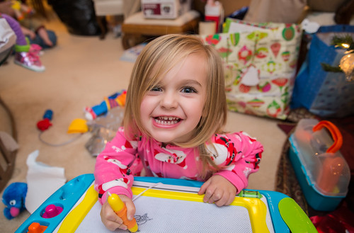

So, since coming here, I have really tried shooting people further away and cropping in where necessary. This has resulted in more shots like this:
Julia enjoying her new toy by The Braineack, on Flickr
Now the focus isn't just about her smile, but you can see what she's smiling about--Christmas presents!
