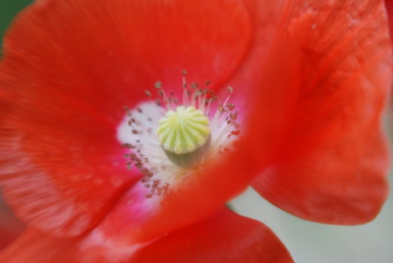

This was my first attempt at reverse macros...i never realized how short the focal length was! anyways, let me know what you think!
Thanks!
Jeff
looks like you're having the same problem i was... very narrow DOF and soft images. i like how the flower one looks, was this just done with the lens held on the camera backwards or do you have a reverse mount?
i was just holding it, my digi lense doesnt actualy work for this, so i was using my old pentax film lense for it, its realy fun, but as you mentioned pretty hard, but yea, i was just holding it onto the camera.
Jeff
did the digital lens not work because of the non adjustable aperture while not attached to the camera?

well theres a first i think for me, i've never inspired anyone with my pics before i don't think! and as for the digi lense not working, i think it is becuase of the no adjusting the aperture, so shorty i think you're right there.
and Polygon i used a really old (from '76 if it came with my old cam) Pentax lense. It doesnt actualy say the size of it on it anywhere, im not entirely sure why, perhaps it got scratched off, but its a fixed lense, and its pretty small...i have a zoom, but i couldnt get it to focus.
Jeff
flower turned out really good, maybe some post-processing, levels should remove this "foggy" look...
couple of my own, e500 zd 40-150+14-45, with homemade ring coupler to connect, it's extremly hard to focus holding lens in front of other, much easier with coupler...
