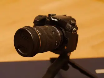

Hi Justin - Congratulations on finding this classic lens for such a good price. I have the Sigma 18-50mm constant f2.8, and it's a terrific lens - but you should be aware that it was designed for classic 4/3 mount cameras - not micro 4/3.
The old 4/3 format was Panasonic/Olympus' first foray into digital interchangeable lens photography. A little over a decade ago, they introduced a whole line of relatively small DSLR cameras with 4/3" sensors that were pretty decent - but Canon and Nikon absolutely crushed them in the marketplace (partly because the sensor was smaller than APS-C).
So they came up with the idea of taking the mirror out of the camera to make their cameras even smaller and lighter, and, about 5 years ago, micro 4/3 was born. Sadly, that meant changing the distance from the lens flange to the sensor - so the lens mount had to change. That's why you need an adapter (like this fairly expensive Panasonic DMW-MA1) to mount classic 4/3 lenses on micro 4/3 cameras.
With the MA-1 adapter, most 4/3 lenses are fully compatible with micro 4/3 cameras - but their autofocus motors are noticeably slower and noisier than modern micro 4/3 glass - and most of them lack O.I.S. (lens stabilization).
They are also generally larger and heavier than micro 4/3 lenses. Here is my Sigma 18-50mm constant f2.8 (without the adapter) side-by-side with a Panasonic 12-35mm constant f2.8 for micro 4/3 (rented from borrowlenses.com so I could compare the two lenses):
And here it is on my GH3:

BOTTOM LINE: if you can afford the adapter*; if you are willing to put up with a relatively large, heavy lens; and if you don't mind slow, noisy autofocus - this is a great lens, and it produces image quality comparable to the much more expensive 12-35mm constant 2.8 from Panasonic.
I do like this lens, and I recommend it - as long as you know what you're getting into. If you want it, you should jump on that Amazon deal - these lenses are hard to come by.
