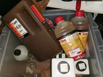

I have a dark brown 4L plastic storage jug almost full of working strength (4+1) TMax developer. It was mixed in 2017. Should I chuck it? It's been kept in the back of a dark closet all this time. I also have x2 full, unopened bottles of TMax concentrate with a brown hue. Some say add 50%-100% developing time to older developers. (see image)
I have a half brown stock bottle of Fix, mixed the same time.
Should I chuck that as well?

My experience is that Tmax developer doesn't last long. Drop a cut leader in it (glass jar) and see how long it takes to develop if it does at all. I only use it as one shot for pushing black & white film, mainly p3200. I haven't cared for it other than pushed film.

thanks! Yes, it's finished. I put a small cutting of TMax and HP5 and didn't even turn.
T-Max is a liquid developer that will turn after it's expire date a lot faster than the powder counterparts. I tried using a brown tinted T-Max with a test roll and it did not work.

I dumped that working solution. I do have HC110? and D76 powder as well.. I've been out of the loop for a long time. I used to work as a draughtsman and darkroom copy photographer in the late 80's, I've gotten so rusty.

I mixed 1L of TMax Developer concentrate, (the darker one,) and my film leader turned black with int two minutes. Likewise, another film leader cleared under two minutes with the Fix I had mixed a couple of years ago. The storage bottle was the dark brown Datatainer one sees frequently. Thanks for the feedback...!
