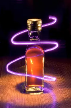

You can also use bottles on a surface to add to the effect and use a maglite to take images then overlay in PS
Steve
