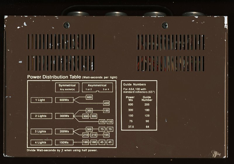

In a small room, like a 12x10 area, 500- or 600 Watt-second flash units are going to be grossly overpowerful. They will be a regal PITA is such a confined shooting area. Even my JTL 300 Watt-second monolight was far too powerful for easy use in a big 20x24 foot vaulted ceiling living room...I was always sliding the thing's power slider allllll the way to MIN. I would rather have five, Flashpoint 320M monolights, at 150 Watt-second each, than three Alien Bee whatevers, or two 600 W-s Einsteins.
Five-light and four-light setups in a smaller area are a lot more fun to shoot if your lights give you flexible, controllable, appropriate power distribution.
Here is a scan I did of a Speedotron Brown Line D604, 600 Watt-second power supply, and the Guide Number chart showing real-world GN's at ISO 100, in feet, for 65 degree beam spread 11.5 inch parabolic reflectors. Again--this is 65 degree beam angle...so this would be like 35mm zoom head on a speedlight.
