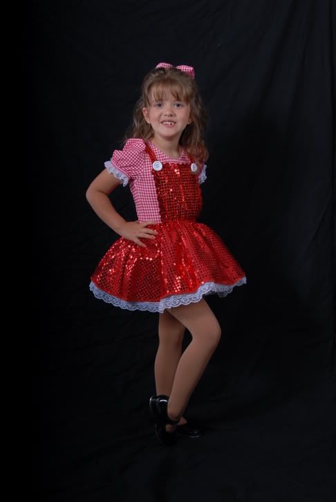

Hey All,
I haven't had a ton of time with the new lights and camera. Summer has been busier than I expected, but I was able to do a few of my daughter before her recital. The photographer they had at the dance studio was not that good, so I am hoping to snag that job or at least book a few sessions from some of the moms there. Let me know what you think. They are a little dark on my screen, but prints came out pretty nice.
They look dark on my screen as well. Also, her feet are almost lost in shadow on both full length shots. While having the face be the brightest spot can often be good...I think they would look better if the lighter was more even. Try moving your light lower.
I'm not sure what happened with the upload. The feet are much more visible on the originals. The one thing that bugs me is that my back light was not set up strong enough. I was messing with a shoot through umbrella. I had like 15 min to shoot because the girls where running late.
