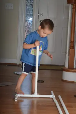

So, I have a flash coming and I ran across the classic Dean Collins Tinker Tubes plans (http://media.software-cinema.com/documents/tt-book.pdf). We are experiencing a few hiccups based on my level of distraction in the home depot (where the heck did these wrong sized peices come from?), but my three year old thinks this could be the best day ever. We're thinking small (panel and light stand), but I can see how this could become addictive.
I love arts and crafts time.:mrgreen:
