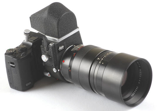

The Leica M Visoflex: Link
The M lenses were made for rangefinder cameras and rangefinder lenses rarely work well on film SLRs so there isn't much of a choice in the film camera world. There are some M adapters for DSLRs but you already know that.
If you want to use Leica lenses on an SLR I suggest getting a Leicaflex or R-series Leica SLR and use their lenses on them.

The Leica Visoflex system pictured above is the only film SLR that can use M lenses but it is expensive and not very easy to use.
