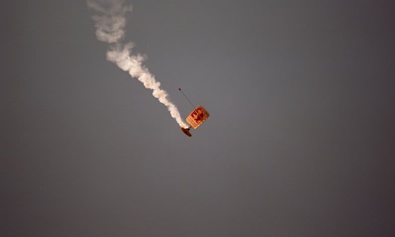

When I take a shot using my telephoto lens looking into deep blue sky while on Ektar 100 negatives, it always gives me gray sky, almost never fails ( actually it's 100% fail rate). When using shorter lens (50 and 20mm), no problem. It only happens when it's a combination of blue sky + 70~300 AF ED lens + Etkar 100.

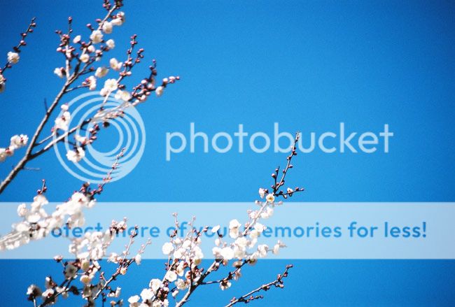

When using consumer grade negatives like Kodak Gold or Fujifilm, it's fine as well. Anyone knows why?
Taken with Ektar100
Taken with Kodak Gold 200
A few more particulars would be helpful. Scanner, software, scanning mode (auto-manual). Possibly lens models.
But to just guess I'd say that the combination of this negative's coloured base and the colour cast of your lens, or lack compared to the others has reach a tipping point in the software's auto colour correction. The software no longer says the background is blue, but should be auto corrected to gray.
Does that help?

My guess is that the sky is going gray because it's over-exposed. It's difficult
to photograph an object against a bright sky without either blowing out the
sky or underexposing the object.
Ektar 100 has some peculiar traits when it is either under or over exposed.
This causes color shifts and/or changes in saturation. I think that's what
we're seeing it in your gray sky.
Using different focal length lenses would change your metering pattern
and that would account for a more correct exposure with a wider lens
because the sky would be nearly all the meter is "seeing" so it would give
a correct exposure for the sky alone.
If my "theory" above is true then a polarizer should lessen the problem
of sky color shift with Ektar 100 when using a longer lens.
Unfortunately I don't have any experience with that particular scanner, and its been along time since I've used the Epson software. With the two scanners I use, Minolta and Nikon, I use Vuescan, Nikon oem software, and occastionally Silverfast. I can dial in manual values quite easly.
If you view the negatives side-by-side do they look like significantly different exposures?
As an experiment you might try setting up a controlled scene. Say, a Greta-McBeth card (or other repeatable objects) in the middle of a blue plastic tarp in open sun. Shoot a couple exposures with each lens on the same roll of film. Then you can compare the results much more effectively.
Changing directions, given that you're having a problem with an ED lens, maybe try a UV filter. Possibly the Ektar reacts badly to UV (a sun-burn, couldn't resist).
