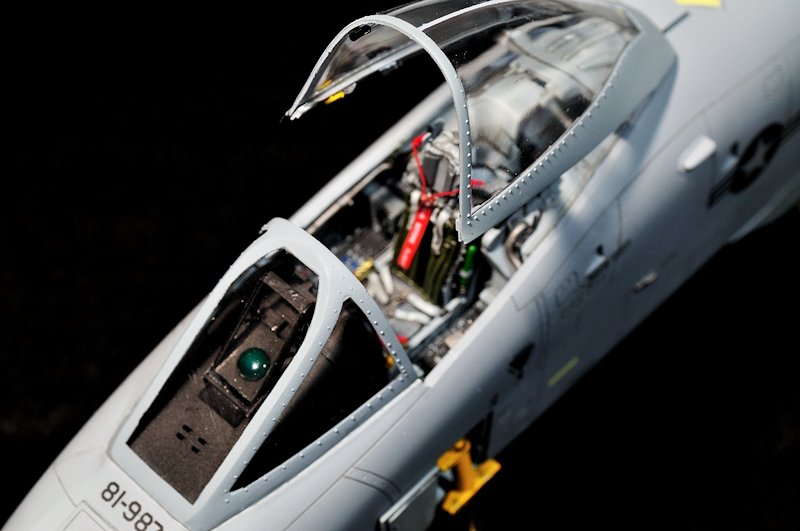

Focus stacking does work very well. I've done it for models and it does work. At macro distances depth of field is so limited that it is virtually impossible to get much of the model in focus unless it's just a flat surface. Focus stacking allows you to take a shot at one focus depth, then another at a different focus depth, and so on, and then "Stack" them into one image. The technique also allows one to use the aperture at which their lens is the sharpest without worrying about depth of field.
Here Is A Shot of a 1/32 scale A-10 cockpit I took that is a stack of 7 images. I started with the focus on the canopy rail on top and kept going down about 1/16" at a time until the seat belts were in focus and then stacked all of the images. There was no way I could get everything in focus with one shot, I tried. Here Is A Shot of the first photo of the stack. The depth of field doesn't go anywhere near as far as I wanted it to.

Two things...
1. That is a PHENOMENAL job on the cockpit. Forget the photo (which is lovely). The detail and work on what is a 1/32nd scale cockpit (that makes the pilot about 3-4 inches tall) is outstanding.
2. I've used some HDR software (like Photomatix Pro) to achieve the same result as stacking.

Thanks. That model was an absolute nightmare from the get-go but it eventually turned out decently. I got disgusted several times and quit on it for a while but eventually made it through to the end. Photos of the finished model are Here.
I can't understand how that would work. HDR increases the dynamic range of an image but has nothing at all to do with depth of field. I'm not saying you didn't, but I can't understand how.
