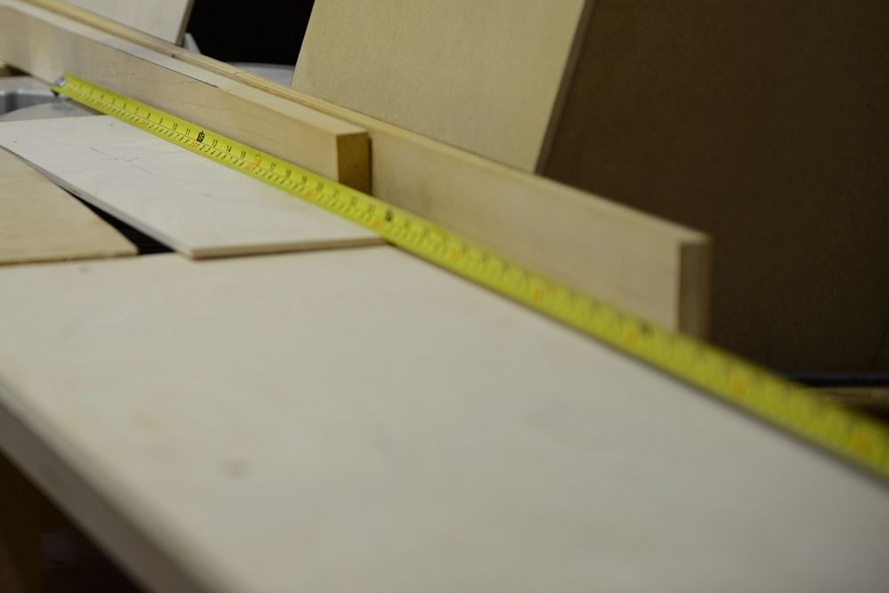

Try this to check for front/back focus issues...
