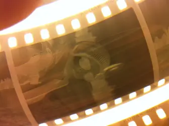

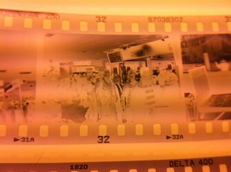

Anyway, here are some pics of the negatives. I've cut them into rows of six, and put them into my "archive". Take a look at the very transparent one, as well as the quite dark one at the end. That one have been laying out in the snow for a few days. I found it again (LOL), and thought I'd develop it to see if it's usable. These pics may be so bad you're not able to tell me anything from them :)

your metering is bouncing all over the place.
The negatives that look black are seriously overexposed and maybe even over developed, it is hard to tell without seeing them first hand.
Are the negatives with the organge mask black and white film, the type that need to be processed in c-41 chemistry? Or, are they color negatives that you processed? And if so, in what?
The ilford black and white appears to be cloudy in places, meaning the fixer is past using. re fix in fresh stuff and rewash.
The Delta 400, is this another c-41 film?
The first three strips on the second group are under exposed.
With beginners, it is common to have exposures all over the place. Leaning to meter properly is a skill that takes some time.

The orange is due to the iphone, I believe. It's not like this in real life.
As for the exposures, how hard can it be to get those right? I mean. I look at the meter. It may say "ev 15". I adjust aperture and shutter speed until "15" is matched on the lens, and I take the shot. I'm really hoping I'm not messing up the exposures, as that is the easy part. If anything, maybe the meter is inaccurate? It's an old camera. However, when I'm out in direct sunlight, I get readings of something like 17, which should fit pretty good with the common charts.
I'd bet it's poor developing rather than my exposures, but who knows, maybe I'm just messing things up in camera.
All of these films are supposed to be traditional black and white films, meant for developing in black and white chemistry. The Delta 400 is, and the Kodak Tri-X should also be. Else I'm very misinformed!
About the fixer, I think it may be a little old, as there's a silver mirror on the inside of the bottle.
btw, everything is processed in Rodinal 1+25. Water as stop and fixed in some Ilford fixer thing :)

I'm glad you mentioned you shot that one picture of your negatives with your iphone - that orange tinge was kind of baffling. Aside from that, I agree with Ann's assessments. Look closely at your first shot and the second column of strips - the top three are clearly much thinner than the others. Why do you think that might be? Question: have you done any contact printing yet? If not, definitely start to include getting a contact print in your darkroom workflow, once your negs are completely dry. When you line them up like this and get a basic print, you will quickly see what is going to be worth enlarging and what's not.

Your camera's meter has both wide-area and spot metering; it's possible that the camera is set to SPOT mode, which can easily,easily deliver terrible underexposures--or horrific overexposures! I see six strips that are badly underexposed, and on the bottom right hand page, six strips that look terribly overexposed. How about the PX625 mercury battery type your Olympus C35 needs??? Do you have the exact, right battery? Exposure determination can be, uhhhh, tricky sometimes...
