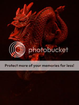

I use a light tent made out of pvc pipe with a white bedsheet for a diffusor and either a black or white one for the background, with $2 150watt work lights (the kind that clip onto the table) from home depot. This isn't a shining example of product photography, but just a general idea of what you can do:
The reflection is from setting the dragon on a piece of plexiglass. In all, I think the whole setup cost about $40.
