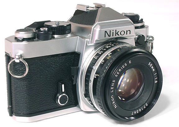

The FM2 is certainly a good choice along with most any Nikkor (AI, AIS or AF)
lens and SB-10 or SB-15 or SB-16B flash. The FM2 is an all-mechanical,
manual-exposure SLR with batteries only needed for the meter.
Other manual-exposure-mode Nikon SLRs with mechanical shutters:FM, F2, F
and the Nikkormats. All are good.

I own about a dozen different nikon cameras. Of the pro-line of cameras the F2AS would be my recommendation, but it's kinda expensive ($200 or more). The other versions of the F2 have older less reliable meters, and probably aren't worth the trouble.
The FM and FE series cameras are good budget entries, the FM and FE sell for as little as $50 ebay--the FM2 and FE2 go for a little more, the only real difference being a 1/4000 max shutter speed vs. 1/1000. The FE and FM are very similar, the difference being that the FE has an aperture priority mode, and a needle meter instead of a led meter. I prefer the FE myself.
Look for something with a 50mm f1.4 ais lens. That lens is worth around $120, if you want to spend less, the 50mm f1.8 is okay and sells for $50 or less. If you have a nikon digital SLR you can also use those lenses, provided they have an aperture ring and are not "DX" lenses.
Of course, if you really want to go old-school, and can live without a in-camera light meter, go for the original nikon F. Stay away from the metered versions, as those meters rarely still work or are reliable. The non-metered versions are nearly indestructible, and will teach you a lot about photography having to rely on your eyes and brains to meter instead of electronics:
A nikon F with the standard prism can be had for less then $200.
For a flash I'd recommend the trusty old vivitar 285hv or 283--which is cheaper. The 285hv can be used on your modern cameras as well without any voltage concerns. I've used the 283 on my modern cameras without any problems, but supposedly they have a higher sync voltage and aren't recommended for modern cameras.

Nikkormats or Nikomats (domestic market as I understand it) have many flavours of metering patterns. My favourite is the basic FT, average reading across the frame, or no weighting of the pattern.
A big problem with these is the shutter speed, iso film speed and aperture interlock are stacked rings that rotate around the lens. The shutter gear train wears out forcing half positions or non-functioning. Iso is very difficult to set, specially if you're becoming farsighted. The aperture/meter interlock is a circular resistor that wears out after many years of use and the contacts lift in some positions causing the meter to drop out. That said they're great cold weather cameras
Minor detail on the Nikon FM, 1 sec to 1/1000th and the FE 8 sec to 1/1000th. My FE and FE2 will lockup if they get to cold. Not enough battery power left to run the shutter circuits. We're not talking sub-zero temperatures either. That means default shutter speed of 1/90th on the FE and 1/250th on the FE2.
Very important consideration when dealing with the older Nikons and their lenses, is the metering system, which has gone through several evolutions. Non-AI, AI and AI-S, they maybe more, you'll have to check to see which lens will work on which camera. Mostly its metering problems, but I believe a couple of bodies won't accept some of the earlier lenses because of physical interference.
