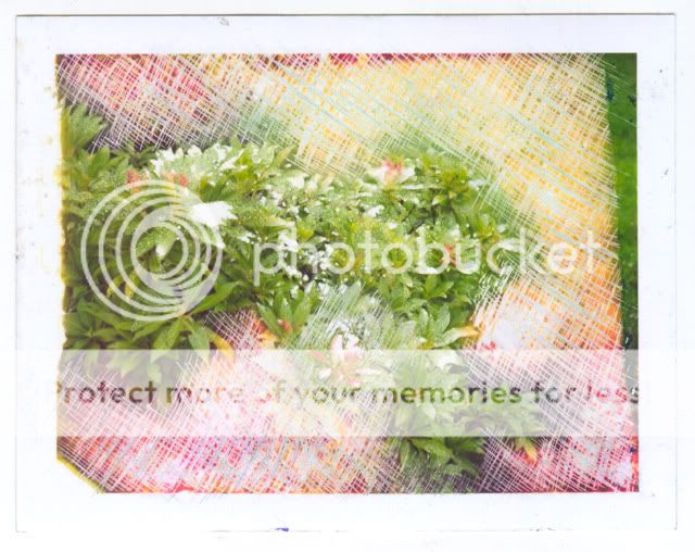

Whilst attempting image transfers I had a couple of test shots "left over" to get the correct exposures so I wanted to have a mess with them.
This was a shot of a shrub in my garden. I scratched out the details I didn't want then smudged the scratched parts with vinegar (which also mixed the colours!). Next, after being told not to use stop bath to finish an image transfer (thanks Terri!:D ) I lightly wiped the whole print with normal strength stop bath which altered the colours of the brighter, red leaves and left a slightly glittery finish to the print.
I am quite pleased with the end result considering I don't know what the hell I'm doing! :lol: Please let me know what you think of it either technically or aesthetically. Many thanks.:thumbup:

Does freaking awesome help? ;) I absolutely love the effect - don't know how it would look with other images, but it's magical in this one. :thumbup: 690 film, eh? I'd say this was an experiment that worked!
Love your scratch lines in the first image, too. I'd say those reds turned out great (helps to have them surrounded by green, its complement color). Beautiful print, all in all. So you're saying the vinegar totally bleached out the scratches? Wonderfully surreal impact.

On the first image the stop bath has slightly raised the remaining emulsion making it appear kinda embossed!
