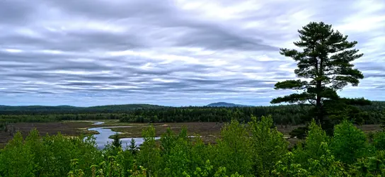

My first "outdoor" HDR photo.
Ernicus
May 18, 2012
2,689
337
Old Town, ME
Well, two things went against me. I got a late start to the day which put me at the spot I wanted to shoot at noon, and I wanted bright sunny day to practice on but instead cloud cover rolled in. I shot anyway and here is what I got. Feedback appreciated. Not sure if I like the original size or the crop better.
Don't care
for the edges when zoomed in on the skylilne and big tree...when I checked the remove ghost thing it made the clouds look really fake and fine lined...surely theres somewhere in between.
Since you were doing your indoor shot competely bass ackwards it would be better if you tell us what you did here so we will have a better idea how to help you. Id say your overerexposed shots dont go far enough to start with.
Since you were doing your indoor shot competely bass ackwards it would be better if you tell us what you did here so we will have a better idea how to help you. Id say your underexposed shots dont go far enough to start with.
:lol:
lol. I started with 1/10 sec f/11 turned 3 clicks and shot stepping down to 1/2500 sec f/11
I tried to do 4 over, one middle and 4 under. would it be easier to resize and throw them up here or can you tell by the numbers?
Do you have AEB on your camera? If you do I would just do that . Also are you shooting in aperture priority or manual?
This scene you could easily have just used +2,0,-2 , unless you are shooting directly into the sun most day shots are fine with 3 exposures 2 stops apart........
As far as the image it self the processing is not there and the composition is not good. The sky has clouds but it also is boring and you chose to have more of that than land. On that note the land is also boring. Just not very well executed shot.
How did you decide to start with 1/10 second as your most bright image? Would you mind posting that image?
I took a few pics that were over exposed and decided that setting was very overexposed and started there. Sure, i'll put it up.
I was shooting full manual mode. I dunno what AEB is, still kinda learning this camera...I can check the manual. lol.
Good info
While I appreciate all feedback, this is sort of a carry over from my other thread where I was practicing in the house, not sure if you followed that one or not. While doing these exercises, my focus is the procedure. Gathering the exposures, correctly, compiling and editing so they come out like I want. So that when I do find a nice scene I want to shoot, I will do it correctly.
This was just a pull of section of the highway, nothing special about it. Other than someone thought it was scenic. So framing and composition were not important on this exercise. I chose the sky over land because the land would not move, the sky would. I wanted to see how movement affected this sort of photography. Whether I shot more land or more sky, the result would have been the same...a boring landscape picture, which is irrelevant for me in this exercise.
You dont make things easy for us trying to understand what you are doing. There is no EXIF data with the overexposed shot. Was that shot at 1/10 sec at f11? Its too overexposed for any image I would use, and yet if it was used your final image is too dark in the shadows to account for that.
LOL, well I can't help you understand if I don't understand completely myself. Not sure why no exif data, odd. But yeah that was the 1/10 sec f/11. I'll play around later and pull out one off each end and see what changes, so forth. Obviously I am just going through a lot of trial and error while I read and learn.
I tried another tonight while shooting water flowing over a dam. Disastrously failed attempt. Not even gonna post to get advice on that one. I'll just call it fail. lol.
