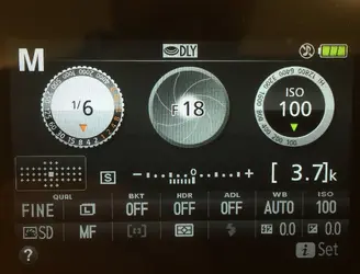

I have attached two photos to show our setup and my camera settings - to be honest I cant see my boss changing the lights as the photography gets a fair amount of traffic (unfortunately) so things get knocked occasionally and a couple of other members of staff use the setup from time to time for quick shots of things so it needs to be simple as possible for all to use.
So with the aperture at f/18, that is not too large, but you're still a bit under-exposed according to the meter. Since you've got a good tripod, you can probably increase the shutter opening, but you might need to use a cable release (or the self-timer). Cable releases are quite reasonably priced. One of mine cost less than $4. USD
Try opening the aperture to say around f/8 or so, and increasing the shutter time a bit. If your'e still getting OOF areas, perhaps a different lens would help. I don't have any specific recommendations at this time.
Good info and your settings look fairly appropriate for the situation. If you can post an example of a photo you'd like to improve I bet somebody will nail the answer.

Thankyou ill try adjusting the settings as you say :encouragement:
