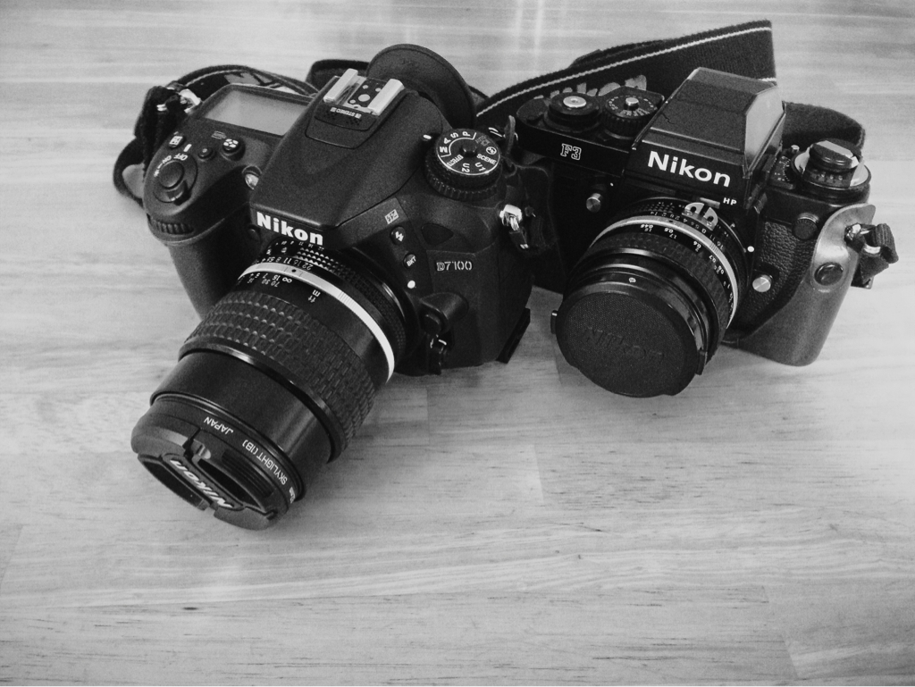

105/2.5 for the win man!!! On the F3, that is one sweeeeeeeeet-shooting lens! The ne plus ultra of 1980's Nikonism!!!
Yes, the 105/2.5 Nikkor is one of the great tele lenses. It's a must-have for Nikon owners.
You know, I also have a Tamron 105/2.5 AdaptAll lens that is comparable to the Nikkor and can be used on other bodies.
Dunno but I prefer the 100/2.8E--a smaller, lighter lens that gives very little up to the venerable 105/2.5.
I actually had an all black 100mm series E. It was my very first AIS prime, and I picked it up at a garage sale for $20.
I ultimately sold it locally, but that was the lens that really sparked my addiction
I have a 100/2.8E as well. Very nice little lens.
