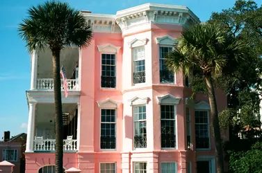

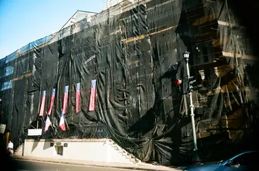

A couple of months ago I bought a Canon AE-1. Yesterday afternoon, I went downtown and shot a roll of Kodak Ektar 100 film that I bought from B & H photo. I brought them to the only lab still in town that develops film. I had them do a normal process and scan the images to a CD. When I came home, I was quickly disappointed to see that the pictures looked pretty bad. The exposure was mostly correct, the color was fine. It just looked like a really low resolution scan. I'm not sure if this is just a standard scan the lab does, and I have to ask for a nice, high quality scan. I used two primes with it; a FD 28mm and a FD 50mm. I use both of these lenses (via adapter) on my GH2 and have no problem with quality. I've always gotten sharp and punchy pictures with them. For some reason, my scanned pictures looked, for a lack of better word, 'muddy'. Blurry, kind of soft, and pretty disappointing. I've attached a few to give you guys an idea.
I've used a Loupe to look at the negative against the light, and it looks fine and sharp (from what I can tell). I'm not sure what the issue is; whether it's the camera itself, the film (hope not), or the lenses in some way (really hope not). Sorry for the long rant; I was looking forward to looking at crisp, beautiful film, and was pretty upset with the result. Any help is appreciated. Thanks! (Sorry for the long rant!)

Rare is the commercial lab than scans film at high-res as SOP. The images you posted are at 1544 pixels long.... not much at all. Fine for emailing and posting om FaceSpace and MyBook, but not much else.
You will have to ask about higher resolution scans, and the cost.
I have had the lab do scans, then I re-scan selected negatives on my flatbed scanner, saves a lot of time for a reasonable cost.
Phil
Those are evaluation-grade scans..useful to look through and see what the images "are", and okay to e-mail or upload for casual use, easily sent, easily stored because, well, they're small and low-resolution scans. For people who are working like Phil is, this size of a scan file is fine...he can select the ones he likes, and then scan them at high resolution on his own scanner setup. Many people would want a much higher-resolution scan, especially if the price is reasonable. MAKING high-quality scans one frame at a time on a home-type scanner (either flatbed or a dedicated film scanner) is a rather slow process; the lab has the advantage of a very expensive and FAST scanner that can scan the uncut film, and that alone saves time.
I looked at your images: I would say the lenses are fine. There's some clues that the lenses are resolving even small details, all the way out to the corners of the frames...but the SCAN resolution, and sharpening, are both low.

I called the lab today, and they did tell me that they did just a standard scan. They do offer a high resolution scan (around 7200 DPI), but unfortunately they charge $3 a frame. For a typical 36 exposure roll, that's $108. I found another that offered to do high res scans for about $15-20 total for a roll. But I may do some research and save for my own scanner since I would like to make this a serious hobby (any recommendations would be great). Again I thank you all for the replies.
Also, the corners of the frames being black were my fault. I used a rubber donut on my lenses that got a little bent in my bag, and folded into frame a little bit. I didn't see them when I took the pictures.
Most Fuji Frontier or Noritsu labs' scan default is what you. Both are capable of higher resolutions that shouldn't cost you more $$$. Just make sure the operator knows how to switch scan resolution. Fujifilm.ca scans my 35mm film at around 3-4MB. Not huge but adequate for web use. Cost is $5/roll for process/scan service. It helps keep the dust off my pet film Nikons.
BTW, the contrast in some your shots is hellishly high which doesn't help.
