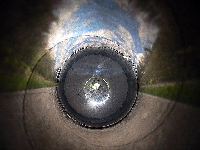

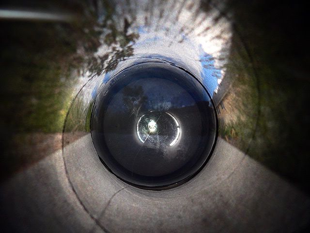

I cut a pringles tube about 1/4 of the way up from the bottom, then put the lid on the open end of the smaller piece. I taped this smaller piece to the end of the longer piece so the lid is basically inside the tube, about 1/4 of the way up from the bottom. I poked a small hole in the bottom of the tube.
The lid is supposed to act as a kind of screen which the image is projected onto, but it didnt quite work out that way for me. Everything is being projected onto the inside of the tube. I stuck the lens of my camera into the tube, pointed it at various things and took some photos.
Here's what I ended up with. I thought it looked pretty interesting.

I read about this technique somewhere. I think they lined the inside of the can with black paper. It forced all the light to project at the end, where you wanted it. Might be worth a try before you toss it?
I just sprayed the inside with matt black paint. It made it a lot easier to see the image but it's still being projected onto the sides. it might have something to do with the little circle/bump thing on the centre of the lid itself.
The image on the screen is a bit clearer in these-

You are getting that result because of the size of the hole. The bigger the hole, the longer the focus length. A big hole pushes the film plane way back, making the image circle rather big. In your case, it's so big that it's washing onto the sides of the canister.
A lot of the pinhole cameras I'm familiar with use thin brass or aluminum sheet that a very small hole is either tapped or drilled through using the tip of a small needle or very small drill bit.
For the canister pihole cameras, I usually see a brass pinhole taped to the curved side, and the film is held opposite. The end is just for access.
