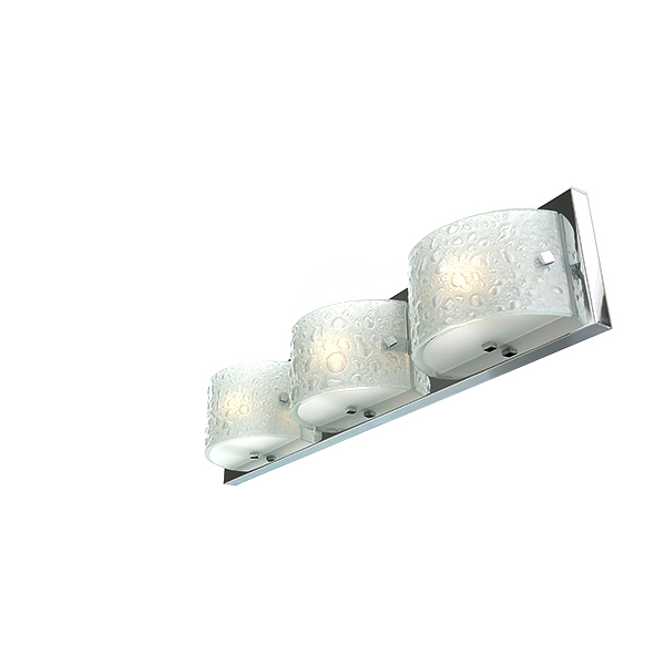

These are some examples of images we have created merging 2, sometimes 3 shots together. Obviously, highlights then have to be added in Photoshop
