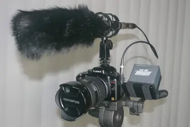

Hi kylesfreelance, if you want to plug a professional mic with a balanced 600 ohm output into a consumer ~2500 ohm input, you will need an impedance matching transformer like this one or this one - not just an adapter.
I use the Hosa cable to adapt a a professional mic to my Panasonic camera. Here is my setup:
Hope this is helpful,
Bill
Hi kylesfreelance - As long as you have a battery powered external mic with an XLR output and adapt it to your Nikon's 3.5mm mic input jack with one of the line matching transformers I recommended above, you should be fine.
If your mic is unpowered, however, there is one more requirement. You will need to find a way to provide it with line or "phantom" power. The least expensive solution for this is the $57 battery-powered ART Phantom II Pro.
Sadly, plugging XLR mics into consumer cameras isn't simple. You may be better off spending $100 for a used Rode Video mic.
Again, hope this is helpful and not too confusing,
Bill
Bill
