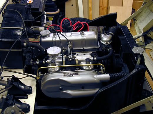

Where was I? Oh yes. Started the car up. It'd been fine all day and it's never broken down on me at all. I heard a loud *bang* so turned it off and inspected the engine. I could feel the fan was loose. Nothing wrong with the engine though. So I drove home with it rattling away like mad every time it was at low revs. Got a huge *bang* as I pulled away from a junction so pulled over and everything still seemed fine. Fan perhaps a little wobblier. Got home and inspected it. It feels like two of the four bolts which hold it on have come off somehow. I found one bolt sitting on top of carb two (the one on the left, the fan is on the far right of the picture below) and a dent in the fan cover on the radiator. That must explain the big bang.
So now I'm waiting for the water to cool off, then I can drain the whole system, take the radiator off, find out if the threads are stripped or if there's another reason for the bolts coming out and then put it all back.

All sorted. Two bolts missing and a third was very loose. God knows why. Assuming they were the correct bolts. They also had spring washers and all was tight when I took it off before.
Not found the other bolt. But found one washer on the bulkhead and another down by the steering rack. Could have been nasty without that fan guard.
I've cut down a couple of bolts so they're slightly longer than the old ones (they're short enough to not be too long) and put on new spring washer. I'll keep my eye on it. I also found some crub coming out of the radiator even though it's had a recent flush. So at least I got rid of that.
