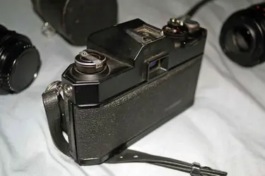

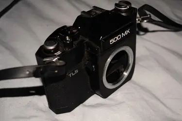

Here are some pictures of what I have. Thanks for the help.
Nice set. Check if shutter speed of 1 sec is about right. Old cameras have most problems with slow speeds due to aging lubricants and dirt in general. However I have 3 Ricoh and all are fine. You may have a problem with the battery for light meter.
The 28 is the wide angle, 50 is normal, 135 is about a 2.5X telephoto and the 2X convertor will work with the 50 & 135. I have always had a 135 f2.8 for all my cameras as it is one of the easy to use and focus lenses for sports. They are also very abundant. The small pin onthe bottom of the lens mount is the piece that will stop down the lens to the exposure aperture. You get wide open focusing as long as you keep the little slide on the lens to the A setting. Check on line for batteries since the old batteries may be obsolete. There are replacements available for most. Good Luck and enjoy that classic. I think you will f ind the shutter speeds go from 1/2 to 1/500 sec. so it will be hard to check on 1 sec. but if you hear the gears on t he 1/2 sec. it should be good also.
