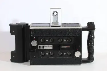

You need a Graph Check:
It took 8 frames on 4x5 sheet Polaroid. The sequence rate was variable. I knew a couple guys who had one and used to hang out at the local golf courses. An instant see your golf swing for 10 bucks.
Joe
It takes a specialized camera high speed film camera and a strobe light that can shoot 50 or more frames-per-second with sufficient power.
