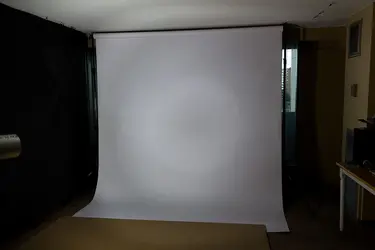

So here is the difference in light between just the can, the square grid and the 3X3 grid
2014-10-09_16-21-12_IMG_2402.jpg 2014-10-09_16-22-58_IMG_2405.jpg 2014-10-09_16-50-02_IMG_2409.jpg
My suspicion is the cardboard is too heavy, but I spray painted everything mat black and now I have to wait 24 hrs before I can assemble and test. The paint dries to touch in about 15 min. But it is too soft and will scratch if I slide the cardboard into the can because it is a snug fit. If the cardboard is too thick, it will be easy to make a thin version since now I have the template.
Notice how we went from lighting the whole room to just lighting a more or less circular spot. That's what a grid does for you. I have little ones that go on my speedlites. They give a nice round circle of light with pretty even fill, which is the objective here, too. The other thing I could do is fill the end of the can with drinking straws. If I see any black straws for Halloween I might pick up a couple of packs.
