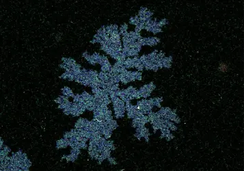

I am thinking it is some kind of fungus also. I have attached a photo I found on the net that is a good example of what it would look like with a close up picture. Someone had the same issue and the discussion there also concluded it is likely fungus. Bummer, but I am glad to know what it is. Thank you for the replies!

Looks moldy oldie to me. See this at work all the time.
