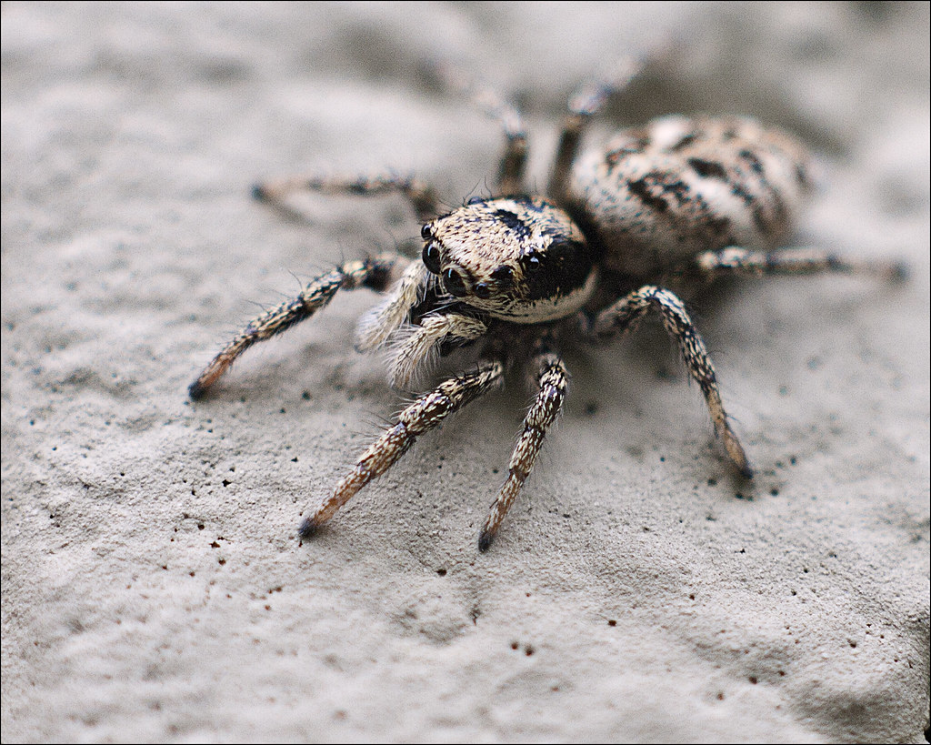

This is your jpg and i used neat image on it. Incase you didn't realize, you shot this at ISO 400.
This is the raw without any noise removal. You are adding noise somewhere because this isn't as noisy as yours...
Thanks, EWdsport.
Yes, I was aware of the ISO 400...I was trying to raise the shutter speed...this guy was tiny, about 5mm long, and halfway up a wall. I was shooting manual with a vivitar 90mm macro lens (hence the f1.8 in the EXIF...I didn't shoot at 1.8, that's what it shows). I was struggling to get a well lit shot (no flash with me...on board flash doesn't clear the end of the lens in 1:1 macro mode...leaves a semicircular shadow),.
All in all, tricky to shoot...
I don't think the 400d works so well at ISo above the basic 100, 200. Shame really.
You should be able to get ISO 400 very usable from the 400D - at ISO 800 things do dip down more noticeably
