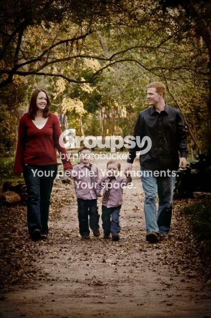

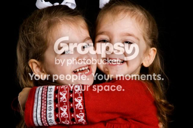

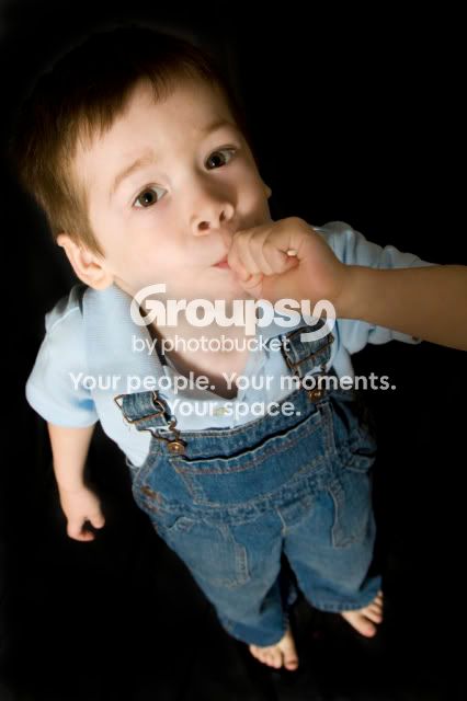

Here is a little taste of my suckage
When I lose my mojo I go out and shoot more pics. Yours aren't bad but I can see where you're coming from. They could be much better. The top one suffers from focus errors or two slow a shutter speed. Also, the family doesn't "pop" out of the shot. A faster shutter combined with a wide open, or nearly wide open aperture would blur the background and isolate the subjects. Also, using a flash to fill in the shadows a bit would help too.
The other two pics are nice captures of the kids expressions, the cropping is ok ( a little too tight on the girls) but the lighting is not the best. Some hair/backlight would have worked wonders on these shots.
yep. The first one I learned the limits of my camerea really fast. Its the noise mostly. Between uncooperitive kids and the low light, it was just a bad shoot from start to finish. And I have been trying to do a back/hair light on the cheep and it isnt working. I am looking for advice on hair/back lights for people who move alot?! Also, I have black muslin and am thinking about black paper instead. Any thoughts?

It looks to me like your photos are all very well composed and framed, only the first one is lacking clear focus.
I can understand why you may not have been happy with the first one where the children aren't exactly posing for the camera, but, hey, they're displaying their true personality.
I think you first of all need your monitor calibrated, I don't know what the prints look like, but these images look green-not a very flattering color for skin tones.
The first image is fine, it just needs the color balance tweaked maybe a little less vignette, and more contrast.
For the studio shots, I'd keep the wide angle tucked away for location work. It's alot cuter when you can see the enviroment, with a non-existent background, it doesn't look right, they're also really difficult to use right. Speaking of the background, the black is overwhelming. Black is too...edgy for kids, and with flat lighting like what you're using, doesn't work. Black commands contrasty and directional light and doesn't communicate a light and cheery mood like what the twins are in. That's the biggest problem that I see. A light gray or white, seamless gelled would be more suitible in my opinion.

I wouldn't worry about changing out your backgrounds, I be more concerned about getting the proper equipment to do the job. if you want to set up some hair lights for "people who move alot" it's not difficult. You have to set some limits on where the subject will be in the frame first of all. Then, get a decent studio strobe light with a small strip softbox and a boom pole. I found one on Craigslist for $150 total.
Trying to do the job "on the cheap" often leads to more frustration than anything else.
I also agree with the above poster that a white or gray background is better suited for kids shots.
I see what you mean about the black background. I have a white one that no one ever wants to use and a blue grey one. I did a really good shoot of a very light haired girl on the black and it turned out beautiful...all the moms have wanted that look but I feel like it is falling short.
