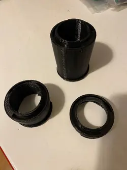

OK, finally got around to printing the tubes and some body caps.
Pros, they do work, all manual of course. Very lost cost, especially for me as I used the printer from work.
Cons, maybe it's the files I chose to download or my printer but quality is not great. Fit is worrisome, not solid, so don't trust them too much. The 20 mm and 40 mm needed some sanding on the body mount side to remove some residue to fit flat against the body. No need to have an expensive lens fall off due to a 25 cent part. Maybe I'll look around for different files and see if they are done better.
Attached are some quick shots I did. Nikon D850, Kiron 105 mm 2.8 macro. All shot at full 1:1, ISO 1000, all hand held of the same subject and position. They will probably look much better on a tripod and more care taken with focus, etc. But only way to focus is to move either the subject or the camera back and forth. All shots with tubes are at F32 and and I let the body set the shutter speed.
The tubes
