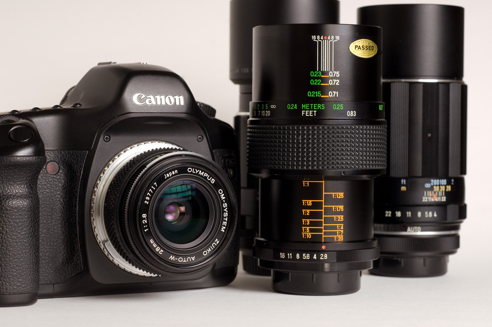

Yes, the mount on Canon bodies is closer to the sensor, allowing lots of things to adapt to them.
Nikon's mount is obnoxiously far away from the sensor and almost nothing adapts. Only 2.5 more millimeters, but that's enough to rule out Sony/Minolta, Olympus OM, Pentax, and M42, all of which Canon can adapt with no optics (plus Nikon lenses).

Adapted lenses on Canon d-slrs are a good combination. Here are Olympus OM-system 28mm f/2.8, Vivitar Series 1 55mm f/2.8 macro, and Super-Takumar 135mm f/3.5 and Super-Takumar 200mm f/4 primes, all of which work pretty well on this Canon 5D classic body. I bought a bunch of low-cost ($14.99 each by the carton of 10) adapters from a Texas-based e-Bay importer.
