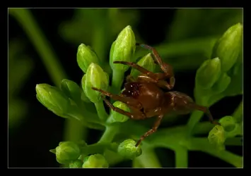

I've never used a true ring flash, but these shots were taken with the Nikon setup. I use it only for macro shooting. I'll also include a shot of the gear itself in case anyone's wondering.
$White-Yellow-Butterfly.webp$Tiny-Spider-d.webp$Bfly-Black---Blue-&-Orange-Spots-b.webp$Bee-d.webp$Flower-Center-c.webp
