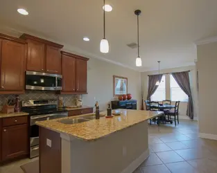

I take a photo in raw. It looks fine. I import in to lightroom. I edit it in raw, it looks good. I export the raw files to jpgs- resizing them to 5 x 3.333 since I know they will be used for a small photo.
I look at the jpegs that are saved to my computer and they look great.
THEN they get uploaded to their final spot, the spot that they need to look good, the spot that I have been preparing them to look good at from the start.......and they look like crap.
My theory, and I could be wrong, is the compression methods are different for each site, for example flickr says they are full resolution, but the site I HAVE to use, must be trying to cut corners or something, I don't know.
Anyway, is there anything I can do to help my photos look better? Maybe DECREASE the clarity to -10, which gives them more of a soft look, and maybe they wont have the weird artifacts and look so bad image quality wise.
The photos are real estate related, so a dreamy, not as sharp look is not a bad thing.
I know photos will help, so let me show you what I mean...
Photo off the website I want to look the same as the jpeg off my computer- $kitchen.webp

When you make a photo smaller the software has to cut out pixels. This often results in the final resized version of the photo being softer. As a result you have to resize and then sharpen your photos. The photos on your website are being resized and likely with a resizing method that does not apply any sharpening (Photoshop has the option to apply it whilst places like flickr apply it automatically).
If you only need 800*600 then resize yourself in photoshops - touch up with some sharpening and then upload and display that size only.
I can really see it in the first but not as much in the second. And I am guessing you are right, the web site is applying compression. The file size is starting at 679 kb and it is being compressed to 33 kb.

After you import in to lightroom and click on "develop" then edit the photo in raw, if you right click the photo and click export, that's how I am doing it.
Then it gives me options as to what folder to put the photo in, file naming, and then image sizing. Right on that screen, I am changing the image size by dimension to 5 by 3.33 with the resolution 300 ppi.
The next option says Output sharpening and I have it set to NONE. Should I change that to sharpen for screen? Low, Standard, and high are my choices.
Is my workflow wrong or what should I try doing?
Remember I am not looking for sharp photos, I am looking for better image quality when its uploaded to the website.

1) You could try to use a file format that doesn't have any lossy compression, like PNG. Chances are if the website is cutting corners they simply won't allow PNG or will have too restrictive of a size limit, but it's worth a try. If it lets you, then you are guaranteed not to have any unexpected compression artifacts with that format. You could still have resizing artifacts, but see #2:
2) You could take into consideration the smallest size monitor that most of your clients are likely to have OR if there is an enforced, standard size the website demands, then that size. Then use a program with high quality compression algorithms to compress it to be natively so that the website has no need to do any more resizing or compression on its own. This may or may not succeed, since it's possible that some places would just run it through an algorithm anyway dumbly. But also worth a try. I notice that one of your images is 1251x1000 pixels and the other is 800x600, so it seems you might not already be doing this. Do everything you can to encourage the website not to have to change anything on its own. If it wants 800x600, give it something already 800x600 and already within its size limits.
Both 1 and 2 in conjunction is best, if possible.
