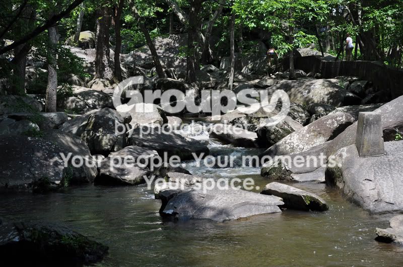

1. SPV464
F4.5, 1/80, 200, 18mm, Pattern, Normal Program

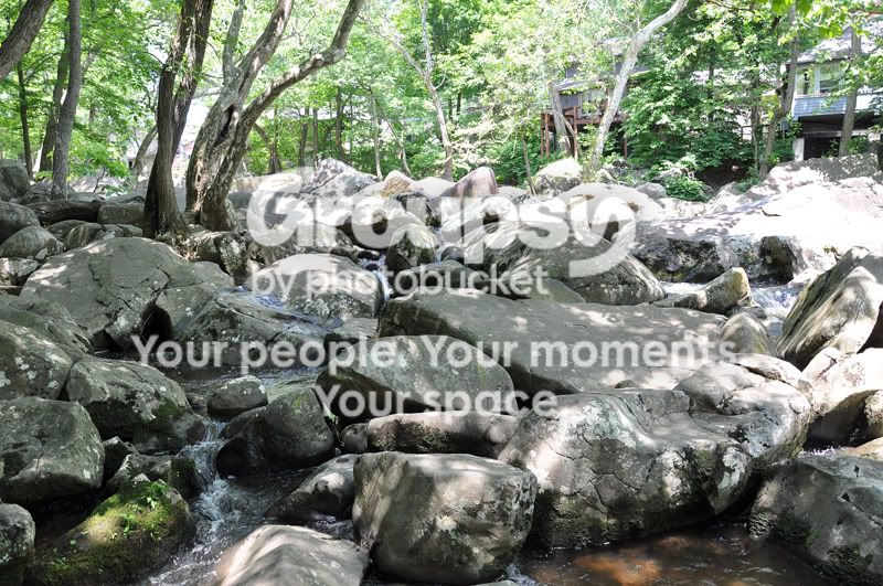

2. SPV 473
F5, 1/400, 200, 58mm, Pattern, Normal Program

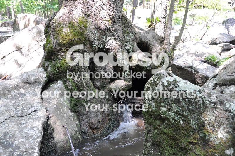

3. SPV 477
F4, 1/40, 200, 25mm, Pattern, Normal Program

It's always tough to shoot landscapes like these under such dramatic highlights and shadows. One Possibility is to expose for one, shoot raw and try to recover in ps. But ultimately you want to try and avoid shooting when the lighting is so bright like this when shooting along the streams. The first photo is exposed pretty well and there arent as harsh highlights. The second 2 you almost will always either have a real bright background or a real dark foreground, or as you photographed, a combination of both. Also never go by the lcd especially when in such bright light, always check the histogram (it never lies) and im sure it'll look like a wide 'U' in these circumstances.

For #3, perhaps that could be tackled with a sufficiently powerful flash? You'd have to diffuse it, I think, and put it somewhere left of the camera (edit: and another on camera or just right as fill), but that might have allowed for better control over the foreground's exposure, no?
Though personally, I'd just come back later in the day, say an hour before sunset, and shoot then.
