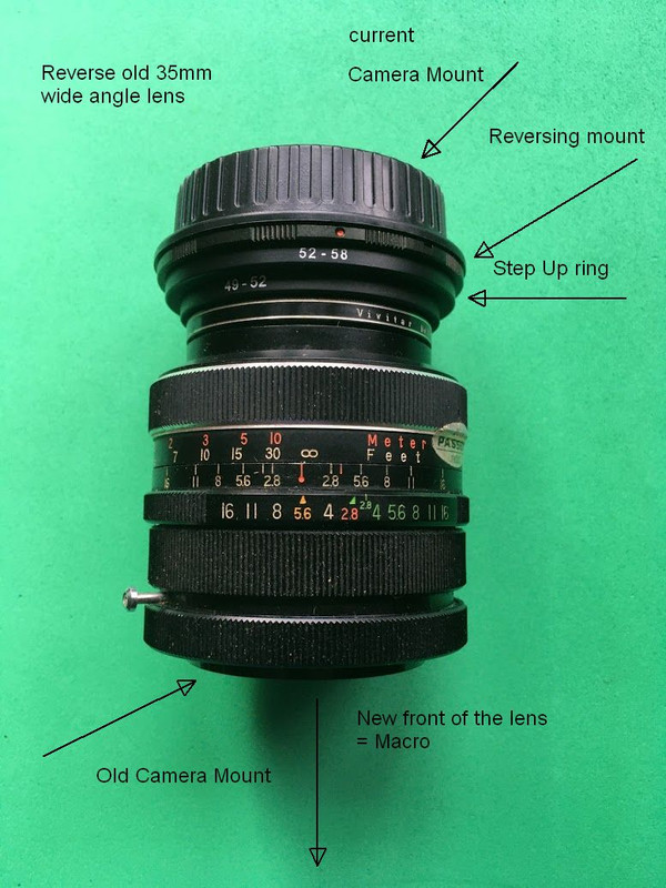

Interesting ideas and yes, an older lens with aperture ring, Thinking about this, I don't know what difference using the back lens or the front lens for that selection?
Still something I had never heard of before and yet another DIY creation that could be useful for someone. Without too much trouble, a step up or step down ring, from the mounted lens to the reversed lens and BINGO, off and shooting.

Yes, I'd think that some dandy older lenses with good quality, inexpensive, can be found for this and adapted.
Myself I have worked with my old FD lens to make the reverse, but now I have to keep my eyes open at the sales and auctions for a high quality older wide angle.
